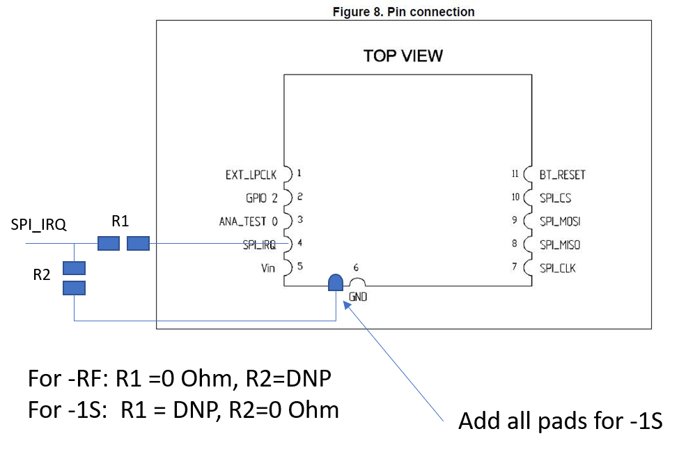

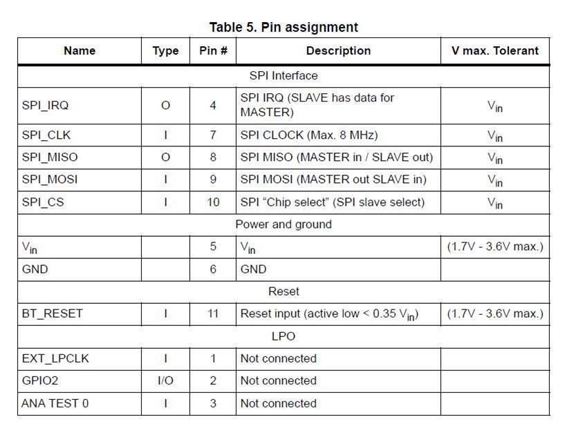

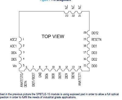

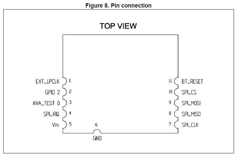

Yes they have different pin counts but the SPBTLE-RF is a subset of the SPBTLE-1S when the SPBTLE-1S is in the SPI mode (mode "100"). The only issue seems to be pin 4, SPI_IRQ.
You mention "If you would like to make SPBTLE-1S act like a SPBTLE-RF,
please flash it with the DTM (SPI one) firmware, and connect to the host processor through the SPI pins."
Does this address the pin difference.  The tables for the "1S" do not show a SPI-IRQ output on pin 4, but instead show it as I2C_DAT,

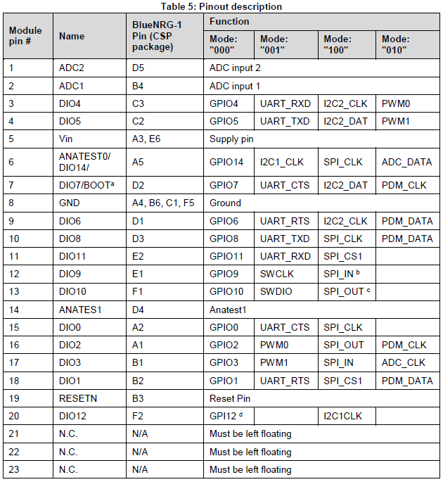

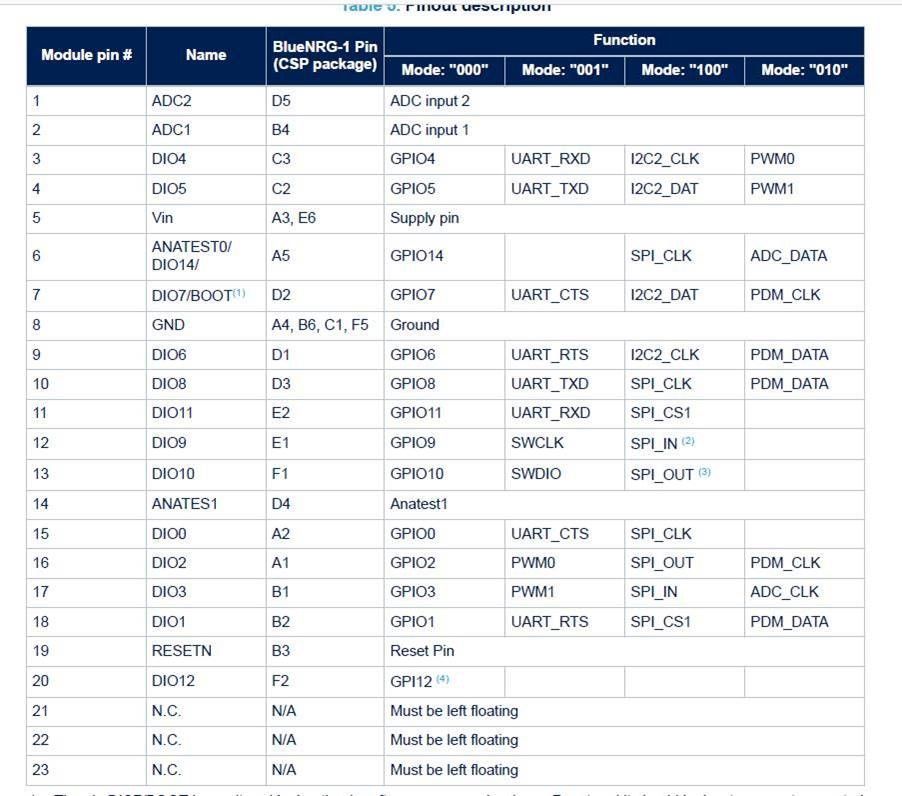

By default, SPI IRQ would be mapped to IO7.
The table of default pins used for SPI interface has been described in
DT0121 - How to configure the BlueNRG-1 and BlueNRG-2 devices in network coprocessor mode
https://www.st.com/resource/en/design_tip/dm00547290.pdf
Feel free to modify it according your needs.
In DTM project, hw_config.h line 54:
#define SPI_IRQ_PIN     GPIO_Pin_7
​OK, but for the SP BTLE_1S, pin 4 on the module is I2C2_DAT.  What pin is that routed to the BLUENRG.  I guess I would need to redefine the SPI_IRQ_PIN to that location used by I2C2_DAT to bring the SPI_IRQ_PIN out of the module. I guess I can download the project to see it.
​For clarification,  for the SPBTLE-RF module, is the BLUENRG programmed in the network coprocessor mode. So that for the SPBTLE-1S, if we program it for this same mode, with the pinout changes to bring the SPI_IRQ pin out pin 4 of the package, the SPBTLE-RF and SPBTLE-1S will function the "same".  We are looking at migrating to the SPBTLE-1S to get access to larger xmit packet sizes.
Per your table, it seems like I could make a footprint that would be compatible with either the -1S or the -RF by adding all the pads for the -1S and proving the following jumpers:
Is this correct?
​I do not believe so.  I believe that he is talking about the pinout of the BlueNRG inside the module, not pin 7 of the module itself.
IO7 would be pin number 7 for SPBTLE-1S module.
Please refer to DS12065, Table 5:
https://www.st.com/resource/en/datasheet/spbtle-1s.pdf
