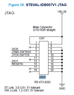

Second thing is, how to flash bin file in BlueNRG-1 (
) using Ubuntu ?(I have segger J-link with installed driver on it)

If you want to flash your .bin files using Linux, you can use the JTAG connector of your STEVAL-IDB007V1 board in SWD mode.
Since you already have J-link, you can use it for this purpose.
As an alternative, if you have an STM32 Nucleo board, you could use its ST-LINK/V2-1 to program and debug the board. In this case, after you connect the SWD pins of your STM32 Nucleo board to the corresponding ones of
your STEVAL-IDB007V1, you may simply copy the .bin file to the virtual mass storage drive created by the STM32 Nucleo board in order to flash your file.
