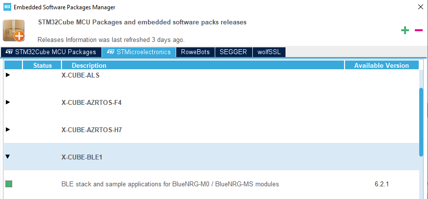

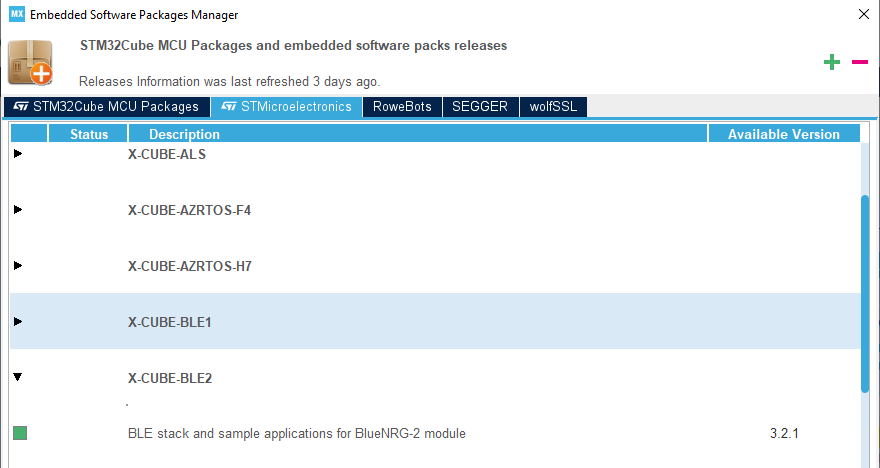

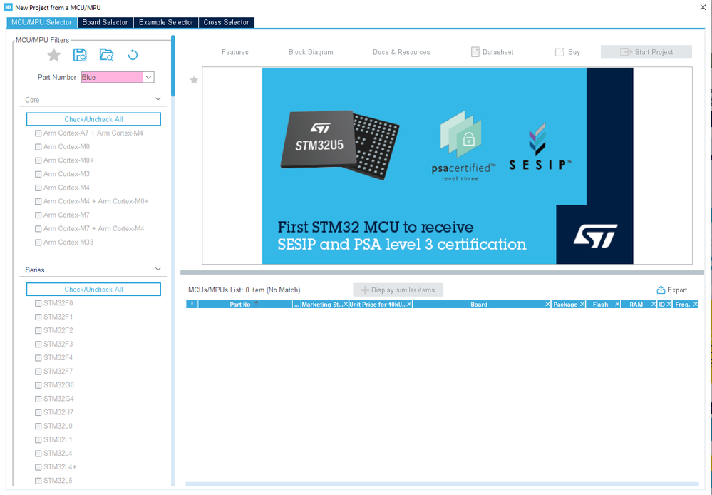

Configuring the BlueNRG chip directly is sufficient, however I cannot find it in CubeMX. I installed both packages: BLE-1 (6.2.1) and BLE-2 (6.2.1) - see attached pictures. Unfortunately there is no component starting with "BLUE" in the MCU Selector. My CubeMX version is 6.3.1.

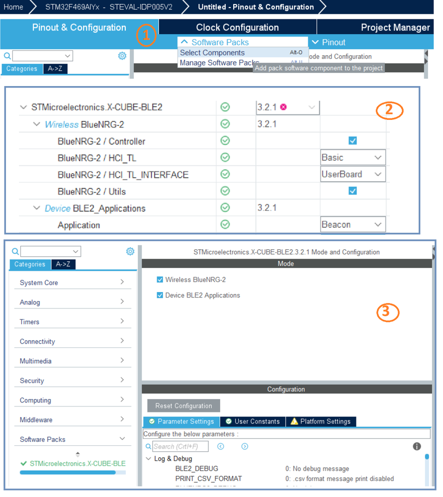

Clear, in fact, in the search PN, you can find only the STM32 products, so you need to enter a STM32 part number, such as STM32H723.., to configure the BlueNRG through CubeMX, please follow steps mentioned below:
1- Create new project using STM32 MCU
2- Select component under Software packs
3- Enable the X-Cube-BLE2 with your configuration, then press OK
4- Configure your pack under Software packs available in the category part
The image attached will help you to understand more the steps described above:
Thanks,
Khouloud

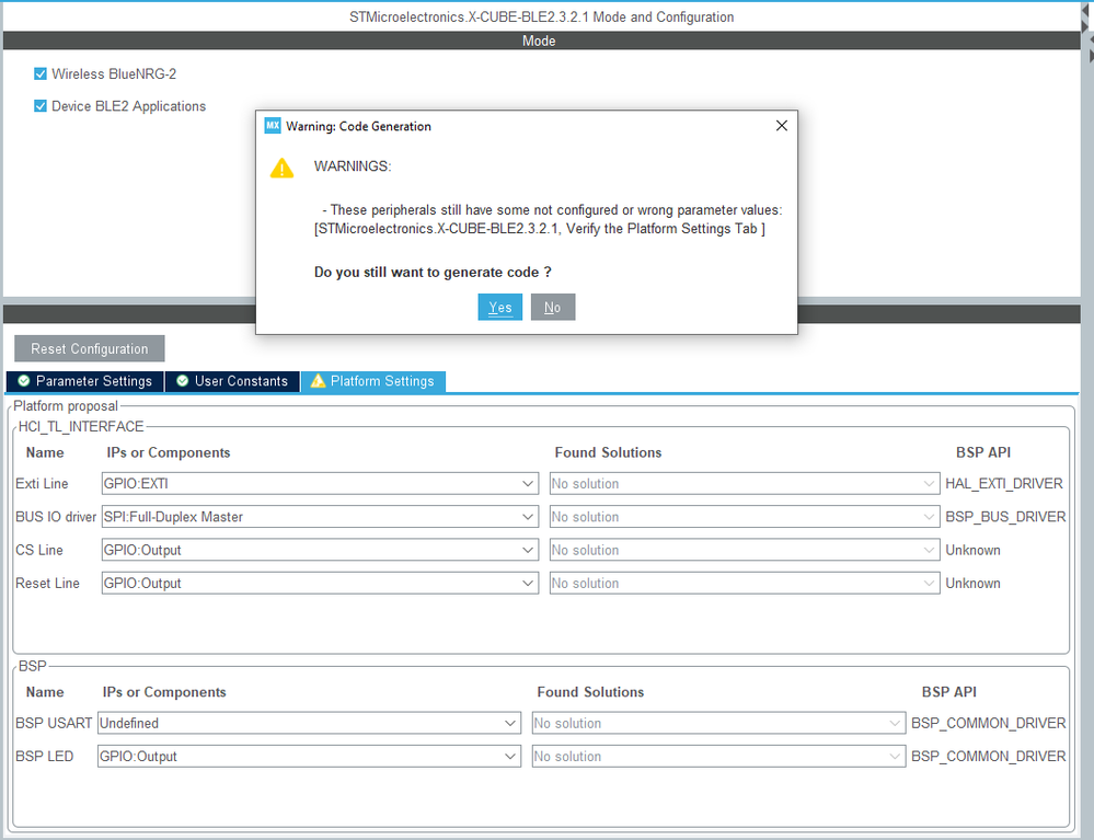

Hi @Khouloud ZEMMELI , sorry for the delay. I tested your advice and I found this package configuration. However, I have some issues.
When I click to generate code, a message about wrong parameters in the BLE2 package Platform Settings appears. The only configurable option is USART and it does not matter what I choose. I may force to proceed with the code generation, but then the compilation fails because of missing "custom.h" and "hci_tl_interface.h" files. I am using Keil.
