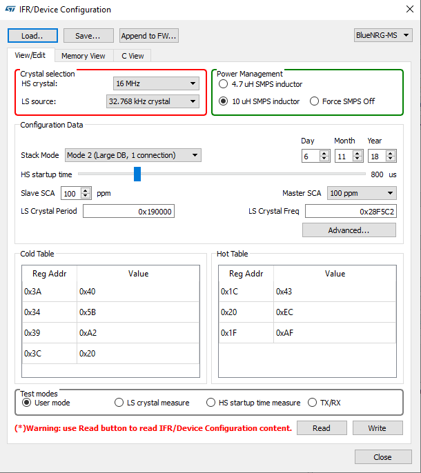

Please use BlueNRG GUI, "menu | Tool | IFR/Device Configuration" to config accordingly.

I too am trying to configure my board's IFR, but I am using the B-L475E-IOT01A (DISCOVERY), for which there is not an option in IFR/Device Configuration. Any idea how I can make this work?

SPBTLE-RF module is based on BlueNRG-MS chip.
Usually there is no need to modify IFR configurations for the Discovery kit.
