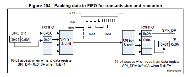

> SPI1->DR = value;
This starts a 16-bit transfer, see "Data packing" in SPI chapter of RM and here on forum. Is this what you wanted?
Generally, you want to observe the pins using logic analyzer and compare the observed waveforms with those given in the sensor's datasheet.

No, I'm talking about Tx. Have you read the "Data packing" section in SPI chapter in RM and have you looked it up here on the forum?
Have you observed the waveforms?

I don't know the sensor's protocol, but as I've said, above:
>> SPI1->DR = value;
