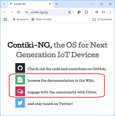

You're going to have to study the Contiki-NG documentation and/or ask on the Contiki-NG community for specific Contiki-NG support:

Those who do are most likely to be found in the Contiki-NG community!
