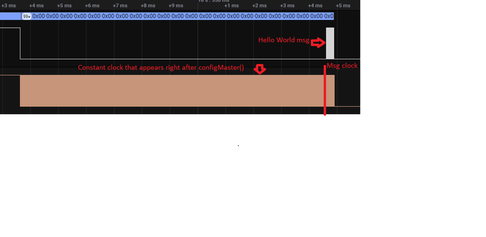

If I add the HAL_SPI_Receive() in between the configurations when I change the node to master the node will then start sending a constant clock through the CLK pin and bring low the DATA pin until I send the Hello World message. So why could this be happening? Is it a deinitialization problem?

}Also the exact point where the master starts sending the clock happens here: HAL_SPI_Init()
/*----------------------- SPIx CR1 & CR2 Configuration ---------------------*/
/* Configure : SPI Mode, Communication Mode, Data size, Clock polarity and phase, NSS management,
Communication speed, First bit and CRC calculation state */
WRITE_REG(hspi->Instance->CR1, (hspi->Init.Mode | hspi->Init.Direction | hspi->Init.DataSize |
hspi->Init.CLKPolarity | hspi->Init.CLKPhase | (hspi->Init.NSS & SPI_CR1_SSM) |
hspi->Init.BaudRatePrescaler | hspi->Init.FirstBit | hspi->Init.CRCCalculation));Any suggestion is welcomed. Thanks
