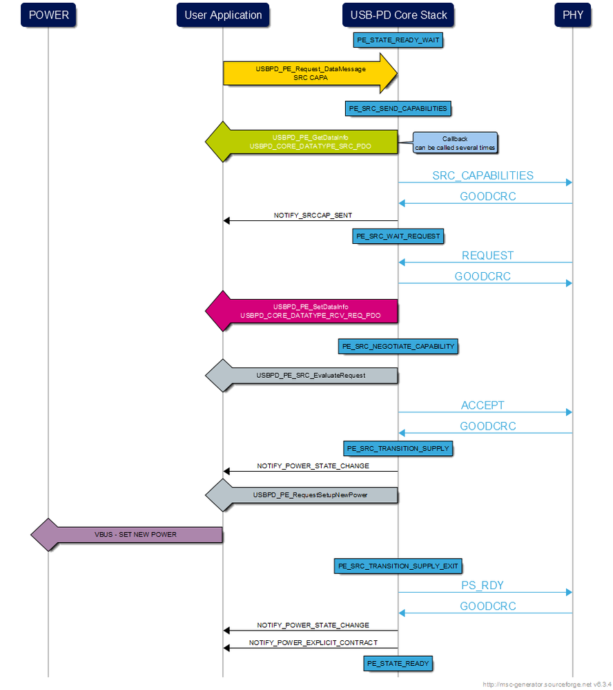

1) by default, when stack starts, it sends a SRC_CAPA to Sink with the list of PDO available in PWR_Port_PDO_Storage[USBPD_PORT_0].SourcePDO.ListOfPDO (copy of PORT0_PDO_ListSRC at init)
2) When contract is established, you can change this list of PDO in adding the APDO and send a new SRC_CAPA message thanks to the DPM function: 'USBPD_DPM_RequestSourceCapability'.
Please find how the procedure to send dynamically a SRC_CAPA message:
For your information, you could find information in the wiki page.

It is always Sink to decide which PDO it wants to use. Solution could be to send dynamically SRC capability without APDO and with APDO to force sink to request changing to PPS.

You can change dynamically this list depending to your use case:
