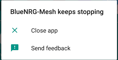

Hi Alok,
Latest version of BlueNRG-Mesh (1.05.00) got crashed on click while tested on Android Oreo/ MotoZ-2 Force.
Although earlier version was working on the same platform.
Best Regards,
VK Verma

Hi Vikrant,
We did detailed testing with Android Oreo on other smart-phone. We don't see any crashes.
We don't have the MotoZ-2 Force smart-phone, hence it is difficult to replicate exactly what you saw.
Kindly help to identify the issue... here are some suggestions and questions:
1. Is the app installed after un-installing the previous one or directly installed from the playstore for the first time.
Can you try to un-install it and try installing again please.
2. Is the location/Bluetooth ON when this occurred?
Normally, the App will prompt the user to switch these ON. However, it is good to check
3.What is the frequency of the crash?
Is it reproducible everytime, any specific sequence or random ?
4. Kindly confirm if you have internet access and enabled on this phone. The App logs the crash analytics. It can help us to identify the root cause.

Hi Alok,
It is still crashing Oreo although i have sent crash report through app feedback. Hope you got the same.
Reply --- It was directly installed from play store and I tried it after reinstalling it again.
Reply --- Yes bluetooth is ON before hitting app.
Reply -- Always, every time
Reply -- I have sent the same.
regards,
VK Verma
2018-05-22 2:58 AM
Thanks VK Verma
We will analyze furtherand also with more phone models andcome back to you.
Thanks
