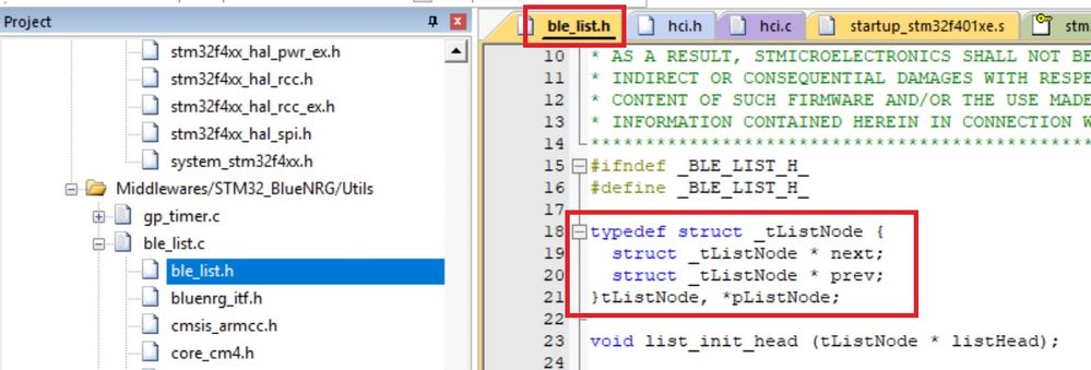

2018-03-22 4:00 PM
tListNode is defined in ble_list.h and is included in the project:
2018-03-22 4:04 PM
