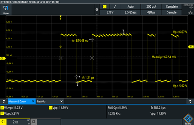

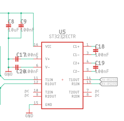

hello, We are using ST3232 as new project design and I measured waveform as below, does this waveform is normal or not?we use 3.3V power supply with 100nF ceramic capacitors. do you have a solutionthank you in advance
