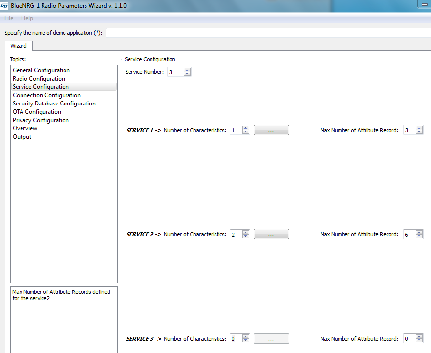

2018-02-21 8:37 PM
Hi Aqib,
Please try the BlueNRG-1 Radio Parameter Wizard, which comes with BlueNRG-1 DK.
In topic ''Service Configuration'', config the needed number of services, characteristics, and attributes,
the reference size will be exposed in ''Output'' topic.
The thread mentioned by Antonio will be a great reference.
