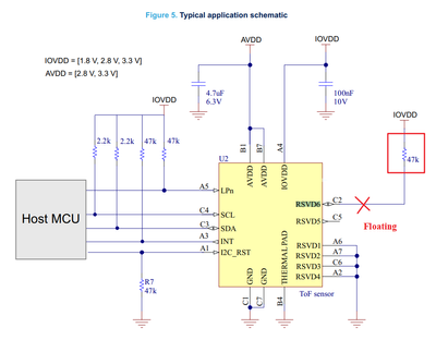

2023-11-14 4:56 PM
In VL53L5CXV0GC Typical application schematic, The pin RSVD6 must connect a 47 kΩ pullup resistor to IOVDD. If I keep this pin as floating, what will happen? Will power consumption increase? Or is the detection inaccurate?
Thany you.
2023-11-15 7:47 AM
C2 is a Unused GPIO. It's an output so just pull it up gently and ignore it.
