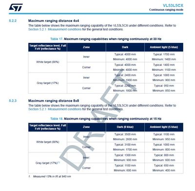

2023-10-27 1:49 PM
It's important to clarify that the VL53L5CX is a multi-zone distance sensor using 940 nm wavelength infrared illumination. It's not an ambient light sensor. With that said, I'll share a section from the device's datasheet where different expected performances are specified under various ambient light conditions because performance is affected. While the second column corresponds to 5 Klux, it's worth noting that, depending on the application and the distance to the target, you can achieve excellent results even with significantly higher ambient light.
