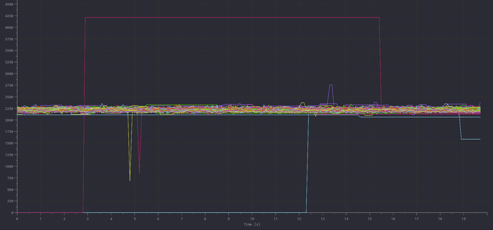

Case 1 : Facing the ceiling, steady
Observation : Takes some time for the outlier values to return to normal value
Case 2 : Waved my hand once above the TOF
Observation : Some outlier values appear (purple blue around 0mm) after my hand are no longer on the TOF

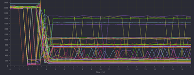

Case 3 : With my hands 20cm on top of the TOF, steady
Observation : Values are fluctuating

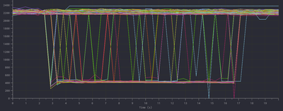

Case 4 : TOF facing the pillows, steady
Observation :
We have also tried to have the TOF installed on the ceiling and facing the chairs & table etc, but the output are fluctuating as well.

Our doubt is that, with case 3 & 4, since everything in the scenario is steady (not moving).
->Why is the output of the values fluctuating?
Our understanding to the sensor is that, if the TOF is facing/ sensing an area with non-moving/steady objects, it should return stable values, and values should not be fluctuating. Is it related to the settings in the fw?

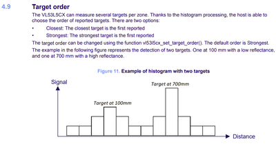

No. In autonomous mode you integrate for maybe 10ms then go to sleep for a 490ms then range again for 10ms. That way you get 2 measures per second but don't spend the power.
Continuous ranging means integrating until its time to start another range. Probably not what you want.
In all cases the L8 is a better sensor. Shift to it if you can.
There are 64 zones and in theory each zone can return 4 targets. But in practice two targets is kind of the practical limit.
If you look down on a bed, some zones will see the bed, some will see the floor. Some zones will see both the bed and the floor.
I generally sort by closest. In most cases closest is strongest as near targets return more photons than do far ones.
But say your floor were particularly reflective and the bedding was not. Possible to have the floor be stronger.
If you go through the structure (and you configure your platform.h to specify 2 targets) you will see them in each of the 64 zones.

The fluctuations are due to the fact that under the covers we do 4, 4x4 sub ranges and stitch them together.  And with fast movement the 4 sub-ranges don't line up.

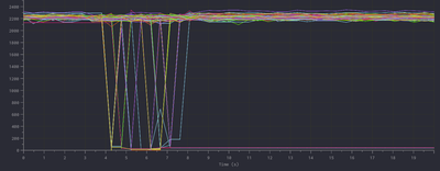

However I have changed the fw setting to what you recommended : Autonomous mode and 10Hz (I assume).
Read for 10 seconds, the sensor is placed steadily and is facing the ceiling, no moving objects is in the FOV.
-> Seems there are lots of fluctuations going on
Other than that, regarding the target order, how does one choose the best ?
Since all the 8x8 values are retrieved from the [1,1] to [8,8] (assume the SPAD to be a 8x8 matrix), how does the target order affect these values?
