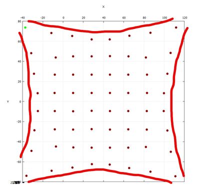

Hi @John E KVAM ,
when I project this code onto a plane normal to the sensor I don't get a perfect square, it's kind of squarish with the corners pulled out. Is this correct? If so, what's the reason the optics aren't evenly spaced in a square pattern?
There also appears to be a copy error in row 0, column 6 from the row above in the yaw matrix (both are 203.2). Presume this should actually be 215.4 to make the matrix symmetrical and it's not a quirk in how the lenses are manufactured?

I was wondering if someone would question those numbers. Well done.
So here is what is going on...
A perfect lens is almost flat, and a long way from the sensor. But this chip is only 1.6mm tall.
So compromises are the name of the game. The 'lens' is a meta-lens (think Fresnel lens only MUCH smaller) and jammed up against the SPAD sensor.
The guy who came up with those numbers ran a huge number of experiments, and then submitted his findings to the chip designer who verified the math.
And yes, the copy error was noted before. I'm very sorry about that.
It was my fault. But now that I'm retired, I can't go back and edit the prior posts.
I just hope people who are interested, will read the entire thread.

Thanks for the explanation @John_Kvam, particularly out of retirement!
