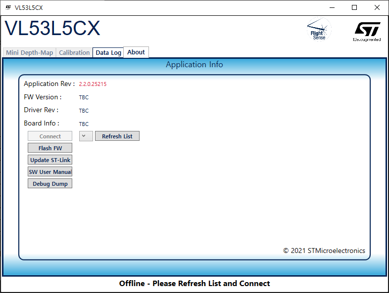

However, VL53L5CX GUI shows no list of VL53L5CX using X-NUCLEO-53L5A1 as the below
Even after pressing the refresh button several times, the result was the same.

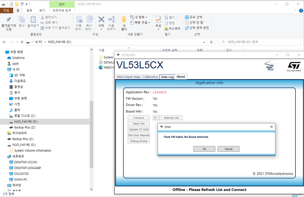

Thanks for prompt response, however I got a result as the below.
However, by using another NUCLEO-F401RE, "Flash FW" was OK.
Yes, you were right. After flashing and clicking on "Refresh List", COM port was shown.
And then "Connect" was OK and "Mini Depth-Map" tab works well.
The difference between the new NUCLEO-F401RE and the old one was that CN11 and CN12 were open, however this is not a problem.
After opening CN11 and CN12 for the new one, "Flash FW" was not working.
But, there is a workaround for this as the below GUI user manual.
4.3 Flash FW button failed (workaround)
1. Check the device is present in Device Manager
2. Copy the .bin file from C:\ProgramFiles\STMicroelectronics\VL53L5CX_Gui\Resources to the
drive with theNucleo device (e.g. NODE_F401RE(drive letter:)) by drag and drop
3. Close the application
4. Unplug / reinsert the device
5. Restart the application
Finally, the new one works well.
And I also found another difference between the old one and the new one.
It was their drive name. The old one is "NODE_F401RE (D:)" and the new one is "NOD_F401RE (D:)"
After changine the drive name to "NODE_F401RE", "flash FW" worked well.
Unfortunately, after flashing, the drive name was restored to its original name.
Best Regards,
Woojin
Best Regards,
Woojin
2021-09-09 7:37 PM
WOW! I had a very frustrating evening until I saw your post!! THANK YOU VERY MUCH!!! Putting the .bin file onto the device made it so I could connect, and then changing the name to add the "E" to make it "NODE_F401RE" allowed me to flash the FW. ST, can you permanently fix these things?!
