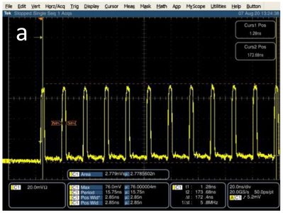

The VCSEL is spec'ed to be 940nm. But it also has a pulse repetition period.
In 'short mode', the VCSEL is on for 2 nano seconds, then off, then on again.
It looks like this:

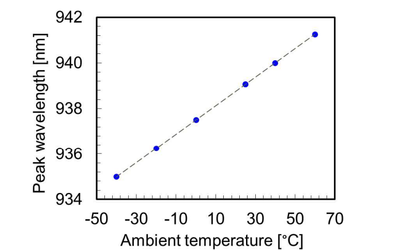

But the frequency does change a bit with temperature:
But I'm going to assume in a medical setting the temperature is reasonably well regulated. So maybe 939nm.

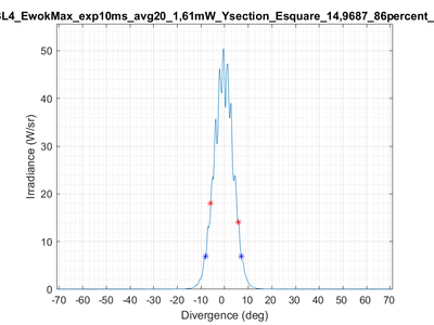

It would be very useful to be able to get some more information with respect to the irradiance of the VCSEL transmitter. I have to estimate  the intensity at 1 meter distance.

Please find below VCSEL power data for L4.
