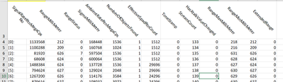

I found that when the anomaly occurred, both the signal and the spad were abnormal, so I suspect it was caused by the spad opening position.
I've uploaded the data from the test, which may help in analysing my problem.

But your numbers are too big. SPAD count <256 for one.
Your status=7 is a 'wrap file'. It means there is an inconstancy between the measurements. You either have motion ,or your target is beyond the max distance of the sensor.

Since I have a lens installed outside of the L4CX, based on the signals I'm reading out, the spads in different area are no longer getting the same amount of signals. (You can check the file attached). In this condition, does it mean that when the SPAD is turned off, the SPAD used might not be in the place with the strongest signal ?
Under these conditions, can I use the ROI to limit the area selected by the SPAD?
