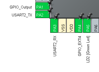

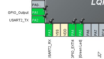

Hi Sid, Could you please send me a picture of the connection you did between the VL53L3CX-SATEL and the Nucleo-F401RE ?
Have you connected the XSHUT pin to the PA1 and the GPIO1 pin to the PA4 as shown below ? Julien

My hookup looks the same as yours.
