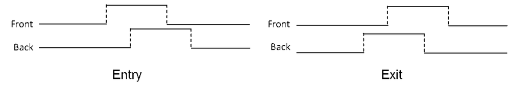

However, I am facing to a big problem according to the accuracy of distances. Even when I fixed the distances from sensor to ground, the received distances is fluctuating. Currently, I set sensor's position 2.3 m from the ground as well as ROI centers in (159, 231), 50ms for each loop but the result obtained while having someone cross the door isn't as expected(should be like the image below).
The normal case: obtained the same distances to front/back zones even when having someone in front zone or back zone.

50ms is too long of a period. In 50ms you will only get maybe one sample of someone in each zone. But probably you will see the person show up in both zones.
Try setting your timing budget to 15ms.
If you can see the floor at this Timing budget you will do better.

You are on the right path ! Actually, we are working to improve the people counting example code we provided. I observed that shifting lightly the "theoretical" center I got better signal rate => better detection reliability. The code should be released as soon as we finished to update the user manual.
(175,231) is the best centers couple which give the best detection rate.
#define FRONT_ZONE_CENTER 175 // was 167, see UM2555 on st.com, center = 175 has better return signal rate for the ROI #1
#define BACK_ZONE_CENTER 231
Concerning the ranging speed, there is no need to go fast for people counting use case. Knowing that the average walking speed is 4~6 KM/ hour. To cross the two areas of the sensor you may need 500 ms or 300 ms depending on the distance between the sensor and the walking people, so setting the timing budget = inter-measurement period = 33 ms you can get up to 15 samples or 10 samples. It is enough, increasing a little bit the timing budget from 20 ms to 33 ms allows the sensor to range with better accuracy avoiding wrong interpretation.
