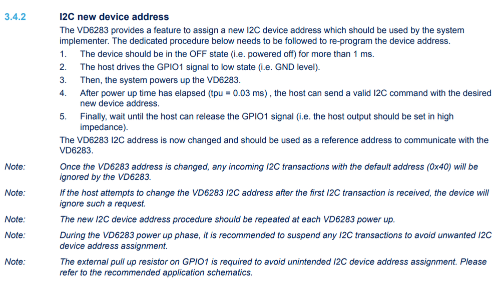

To perform the address change the host must driver the GPIO1 (respecting some timings constraints). Such operations are handled by the system itself and not by the driver.
The way to change the I2C address is explained in the section 3.4.2 of the datasheet.
0693W00000aISZnQAO.pngRegards
