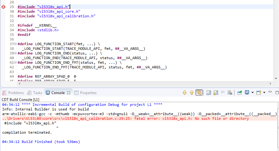

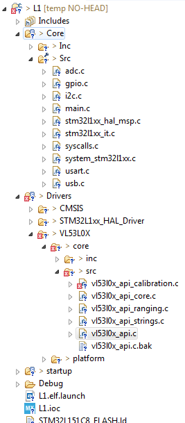

I came to notice that I must include the VL53L0X library to use it, and I'm having trouble doing so. I have downloaded the "en.STSW-IMG005.zip" that contains the library for VL53L0X. I have included the "core" and "platform" folders into my project, but the compilation kept giving me the following error
"fatal error: vl53l0x_api.h: No such file or directory #include "vl53l0x_api.h"
I have included the .h to my main.c but the compilation error jumps from file to file, "vl53l0x_api_core.c", "vl53l0x_api_ranging.c", etc.

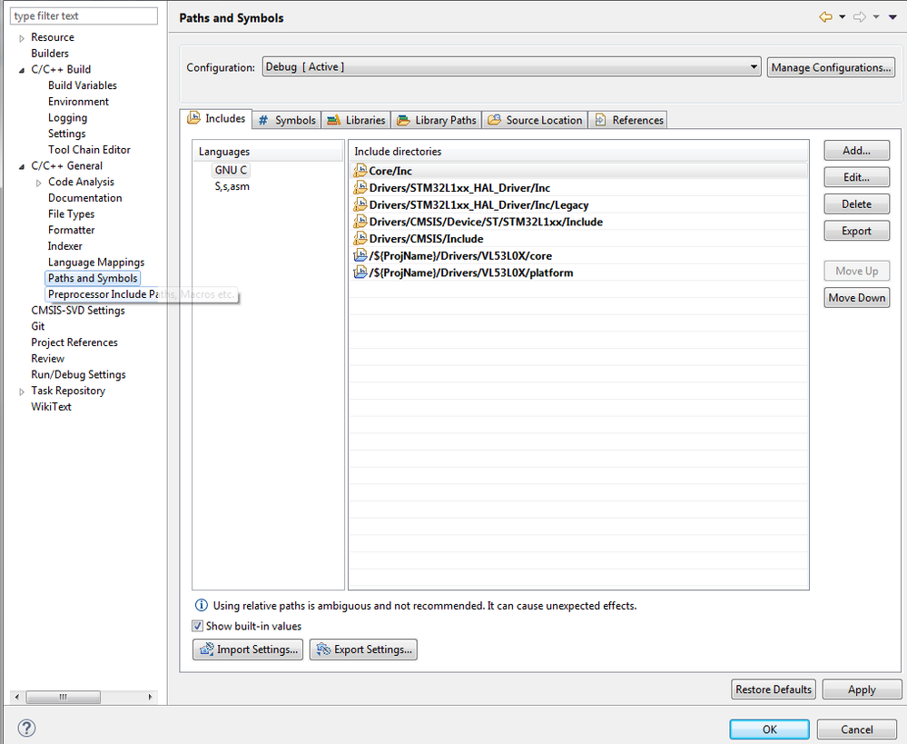

If the files are in your tree - and they should be, it's a matter of telling the IDE where to get them.
click on File in the upper left and then on import. Select the file and it will tell the IDE where to get the file.
After compilation, check the Build Console to insure you see the -I directory.
2019-06-29 1:47 PM
I have checked the build console and all the folders are in the -I directory. Everytime i hit build button the error will jump to another .c file.
