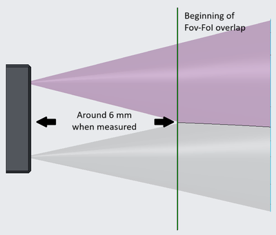

2023-11-10 2:03 AM - edited 2023-11-10 2:04 AM
Hello @AlexCloned
This remark is quite interesting.
Let us look at the VL53L4CD as an example...
The datasheet (DS13812 - Rev 6 - November 2022) for this particular sensor states that it features "short distance linearity down to 1 mm". So down to a distance of 1 mm between the sensor and the target.
This raises a question. If the target distance is less than ten times the VCSEL-SPAD distance, meaning that the sensor is operating under special conditions, and thus the degree of overlay of the emitter and receiver cones is a matter of concern, how is linearity down to 1 mm ensured? Is there anything we (as the clients) need to do to ensure that the sensor functions well in close-proximity conditions (e.g. target closer than 30 mm)?
If we had to model the emitter (VCSEL) cone and the receiver (SPAD) cone, the distance from the sensor at which the field of illumination (FoI) and the field of view (FoV) start overlapping to create the system field of view, can be determined.
This in fact has been done by our team in an attempt to understand better the optics side of these sensors. I am attaching a picture for your reference. The green line in the picture marks the beginning of the FoV-FoI interaction / overlap.
If measured, this turns out to be around 6 mm. Again, a similar question therefore arises. How is the sensor, in this case the VL53L4CD, capable of measuring distances closer than 6 mm and ensure linearity down to 1 mm? Doesn't the 1 mm fall withing a 'blind spot'? Does it still manage to operate well because of inexactness of the cones or diffused reflection of IR light?
Maybe @Anne BIGOT can also provide some input here.
We thank you for your time!
Kind regards,
Brian
2023-11-10 6:37 AM
Nice picture - But if you buy the Evaluation kit, and give it a try you can see that it works below 6mm.
So the question is why.
First thing to note is the bulk of the laser light looks just like your simulation. But there is a tiny bit of light that 'leaks' out at the edges. It's not much, so it cannot be seen past a few cm, but at the very close distances, it's enough.
The other thing to consider is that when the light hits a Lambertian surface (matte finish) photons fly off in all sorts of directions. Your diagram kind of implys that you would have a specular (mirror-like) target. And those are acutally kind of rare.
If you really want to see this close, then open up the coverglass so that ALL the light can get out and back in.
- john
2023-11-13 8:03 AM
Hello John,
We have already bought and used the SATEL-VL53L4CD and P-NUCLEO-53L4A1- products and yes, indeed, it does work below 6 mm.
Your explanation to why (or how) this works is clear and very helpful to us, especially if along the line we would need to go into the target surface conditions.
