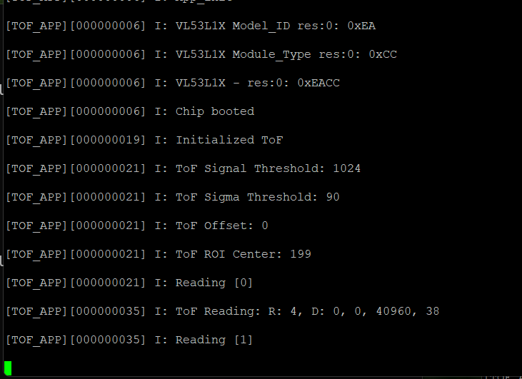

2022-08-06 1:58 AM
Here's the output:

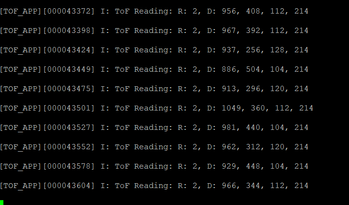

My bad! I took a look at my platform file again, the RdByte function was correct that's why I was getting all the reference registers correctly but I was overwriting the I2C buffer in some functions ( RdWord & WrWord ). Resolving that issue fixed this range status 4 error. Hurray!
Now I'm getting results with approximately correct distance but it's all range status "2". Can you give me some insight on what could cause this?
2022-08-08 7:44 AM
Range status 2 is a:
"2 VL53L1_RANGESTATUS_SIGNAL_FAIL Raised if signal value is below the internal
defined threshold"
The status returns are in the API user manual which is delivered as part of the API when you download it.
Status 2 is the most common status when the sensor does not get enough photons to get a range. And it happens whenever there is no target, the target is too small, or the target is not reflective enough.
It's a good sensor but it's never going to spot knats at a thousand yards.
Place your hand in front of the sensor and slowly back up.
Use that data as sort of a reference.
Everyone is about 50% reflective at 940nm light, and for the most part hands are similar in size.
The data sheet states what the max range is, but the hand range is a more practical indicator.
