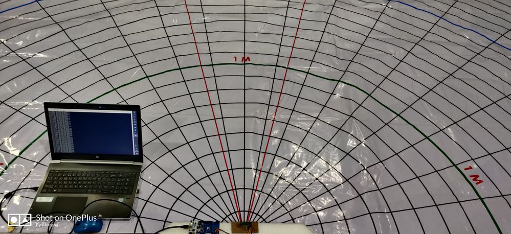

2021-01-14 8:24 PM
Hi ,
I am attaching test setup of sensor. I kept the sensor at the height of 10 cm from ground and obstacle were placed in front of the sensor over flex sheet.
Log File
Regards
Akansha
2021-01-15 2:19 AM
1.I meant that sensor was placed at the height of 15 cm from ground and there was no obstacle in front of it, Still it was giving the ranging distance in range of (850 - 1200)mm. By mistake i have mentioned the unit cm.
