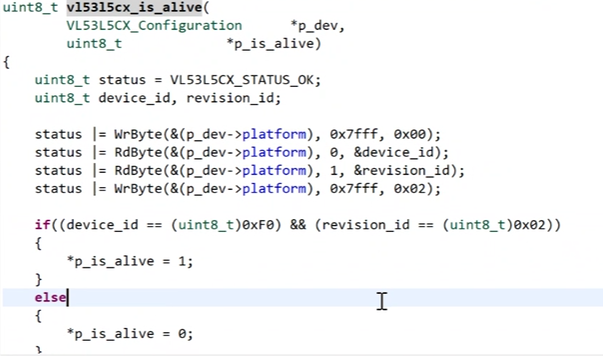

If it's an MCU, then you have to find some way to 'ping' the sensor. Knowing it's alive is the first step.
Can you call the VL53L5CX_is_alive?
It will at least determine if your I2C is communicating. 0693W00000NrXBtQAN.png
