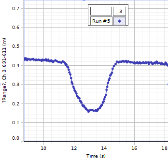

If I point the sensor at a wall and then slowly move my hand into the sensor's viewing area, the sensor gradually changes its reported range from the distance to the wall to the distance to my hand as shown in this graph.
Is it possible to set up the sensor to immediately report my hand's true distance as soon as it is detected instead of reporting a false distance until it has been fully moved in front of the sensor?

The VL53L1X is going to do exactly as you say. However we have a part that does what you want.
The VL53L1CB is what you want.
The chips are almost identical. But the CB version runs different code.
So identical in fact that there is a really, really good chance your X will run the CB code - but it's not guarenteed. (So if you go into production do buy the CB version. It's only a few cents more.)

You will get two targets in the case you suggest. You will see your wall AND your hand.
