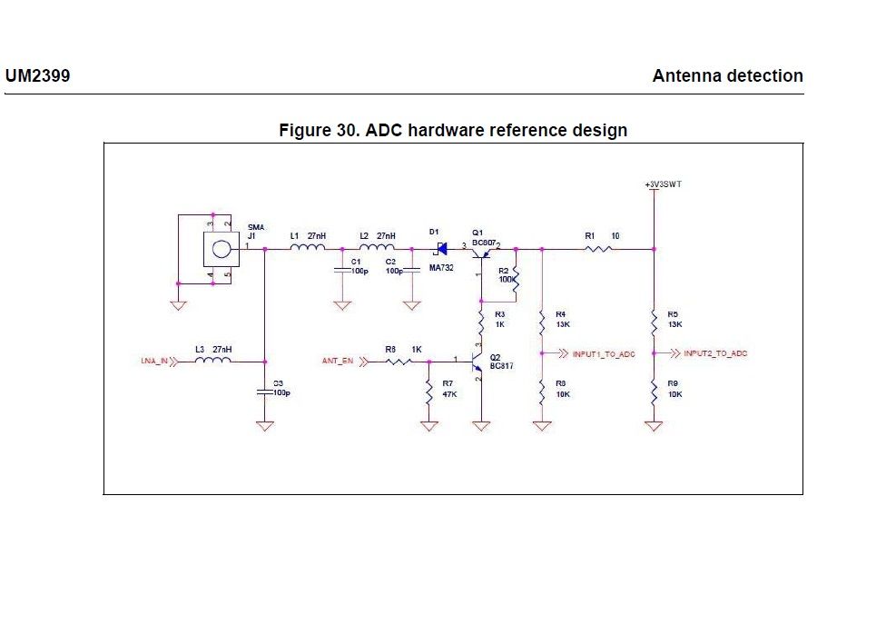

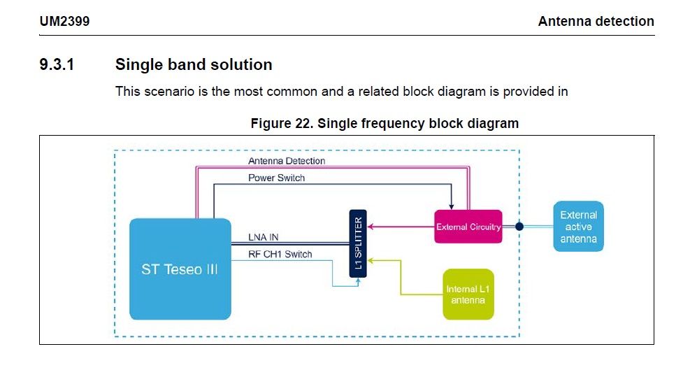

where are the STA8089FG IC internal antenna and splitter?
jg_spitfire
Senior
Hi, the user manual of the ST8089FG mentions an internal antenna and splitter but the datasheet does not talk about it, and even if they were external in the ADC hardware reference design the document does not indicates the model of the splitter or the antenna and does not specify if it is a patch, chip, smd, active or passive internal antenna that must be implemented, or when should be implemented, thanks

Hi
TeseoIII has no internal antenna and slipper. Both should be part of a board.
but STA8089 is not the right TeseoIII for a low volume project.
Regards
Francesco
