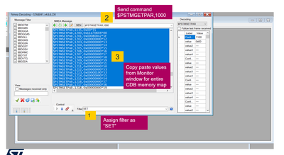

In Teseo Suite, Monitor window, you can send the following commands one by one
#enable Sensor Message
$PSTMSETPAR,1228,0x10000000,1
#increased Baud Rate to 460k to handle extra messages output at 100Hz
$PSTMSETPAR,1102,0xC
# do save and reset
$PSTMSAVEPAR
$PSTMSRR
Kindly let me know if you have further questions.

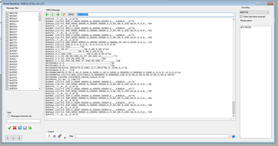

I reflashed the firmware to remove my previous configurations and then executed your commands. However, I still don't see any sign of sensor messages. Do you have any idea what might be causing this?
I successfully reconnected with the 460k baud rate after restarting.
Can you please execute this command in Teseo Suite Monitor Window ?
$PSTMGETPARM,1000
Please copy the CDB values and attach it.
I will compare with the VIC3DA I have.

Can you please reflash with 4.6.18 version?
https://www.st.com/en/embedded-software/teseo-vic3dsw.html and select 4.6.18.
Once you reflash, could you please check if any PSTMDR messages are output.
Common messages are PSTMDRGPS, PSTMDR2? You can filter this is the message output like shown above.
Now you can run the script I shared in the post earlier.
You do not need to disable DRAW, keep the default configuration as is.

Thank you very much!
I tried with version 4.6.18 instead of 4.6.19 and it works fine! I receive gyroscope and accelerometer data (SENMSG 30 and 31).
