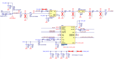

I m working in my design with the Teseo-LIV3F chip, I copied the schematic and routing of the eval board of the Teseo-LIV3F. the amplification stage is also the same that the eval board but I received no GPS or no satellite position.
I read many similar posts on this subject, and the issue is often due to RF section (wrong value of passive component for decoupling capacitor) or antennas. I need a MMCX antenna to connect to my PCB and I think maybe the choice of my antenna is not good.
I attached my schematic and theses are the caracteristics of the antenna and amplification

Are you testing in a location with a good, clear view of the sky? Can a devboard get a fix in that same position?
With RF design, it's not just about schematics - layout is also critical.
And with capacitors it's more than just the nominal capacitance value ...

Yes i tested in a good location, outside of the building on the parking but no difference with inside.
I have not devboard but i will maybe buy it.
For the layout we respect the guidelines on the application note.
I suggested capacitors because this topic seems to have the same issue that me.
https://community.st.com/t5/gnss-positioning/teseo-liv3f-no-signal/td-p/773998
I dont know if my antenna is a good choice, do I need to choose a passive or active antenna? Do you have some choices with MMCX terminaison to suggest ?
