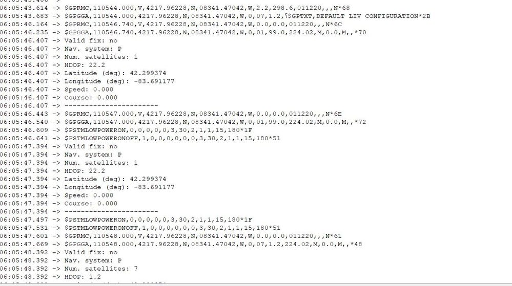

and for the message read from the serial monitor after the code is just uploaded 0693W000006EB2UQAW.jpg
Do I miss something?

Hi, according to my code, I think I send the command "$PSTMLOWPOWERONOFF. However, I do not see the '$PSTMLOWPOWERON,...' answer from the serial monitor...
Thank you
