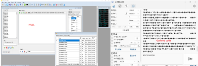

"I would like to ask a few questions:
Initially, I was able to use the EVB-T5DR, and the NMEA decoding displayed information correctly. However, for some reason, it suddenly stopped working. When I used the UART tool to read the data, it appeared as Garbled code. How can I resolve this issue?
Due to the problem mentioned in the first point, I decided to reflash the device, but I encountered a 'sync error' and couldn't flash it.
I would appreciate your help with the above two issues. Thank you.

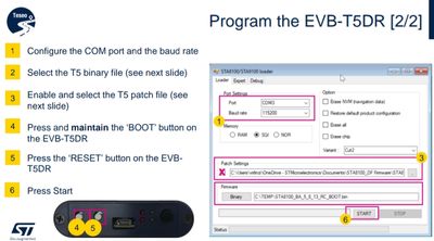

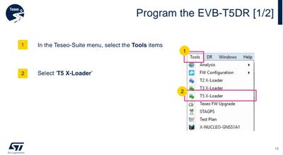

I suggest you:
For the 1st part to follow these steps:
for the second, you should follow those steps:
Best regards.

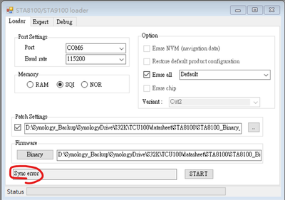

2023-09-14 1:20 AM
I have followed these steps to burn the disc, but it still shows a 'sync error'.

2023-09-28 7:21 AM - edited 2023-09-28 7:21 AM
Try following these steps:
Regards
