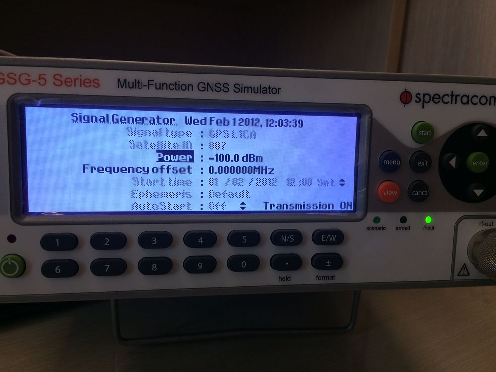

First of all, the project, which is a university-industry project, was given to me by my professor and he give me some data on it. Second, honestly speaking, I don't know what is Teseo-LIV3F. On the other hand my professor suggested me to use this IC (the IC I used is STA8089 GA not 8090, excuse me). By the way, I use a GSG-5 Series multi-function GNSS simulator with the power of -100 dBm (satellite ID-007). Also I used a differential to single ended amplifier to see the IF output but nothing was shown on the spectrum analyzer. On "pin by pin guideline" that I have, it is mentioned that "To enable the analog signal output a software command is required (refer to NMEA commands document)" but nothing is mentioned in NMEA file. You said "IF pins is always", you mean IF pins is always on and no software command is necessary?

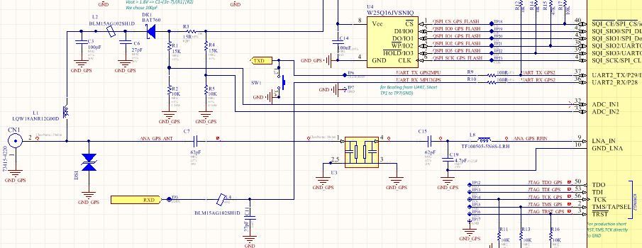

I used an external flash (Winbond, W25Q16JBSNIQ).

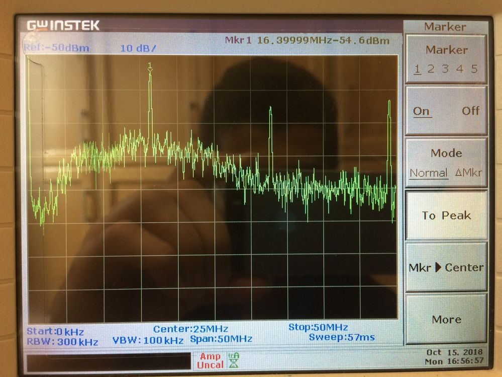

Also I used same schematic you sent. As you said, I used a GPS simulator0690X000006CBV5QAO.jpgThe spectrum Output is shown below

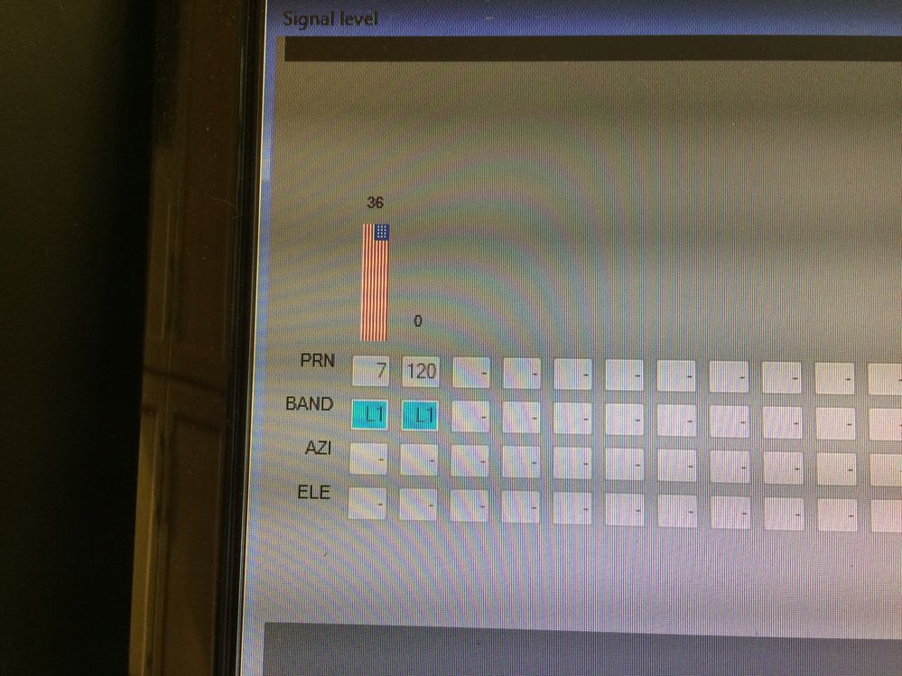

0690X000006CBVAQA4.jpgAs you see, there is no signal around 4MHz (IF frequency). There is just a signal around 16MHz and its harmonics which I don't know where they come from! maybe leakage from PPS. But sometimes the satellite 7 is shown on the software and sometimes not.

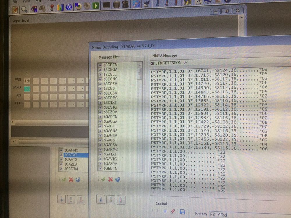

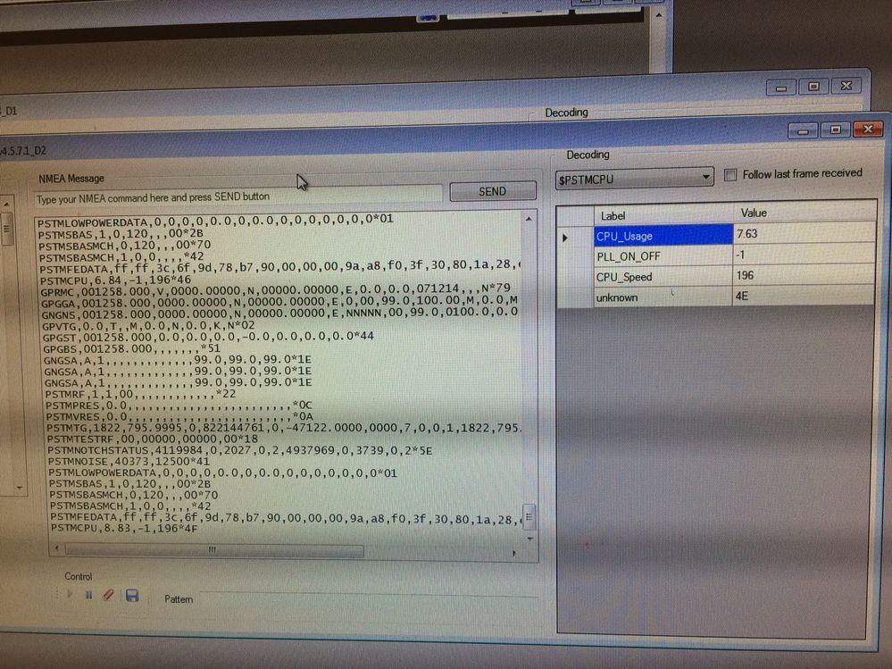

0690X000006CBVKQA4.jpg And something more strange is the CPU usage which never goes further 10 percent (even when the IC detect satellite 7)

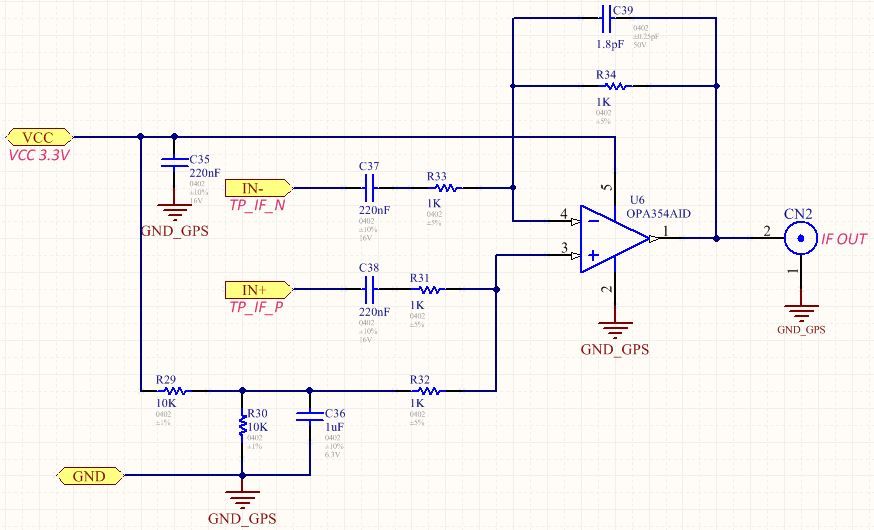

0690X000006CBVUQA4.jpgAs you see something goes wrong in my test bench which I cannot find. I used $PSTMRFTESTON but again nothing was shown at the output of IF pins. Also the differential to single ended structure I used is attached.0690X000006CBVjQAO.jpg

Sorry but in your schematic the signal coming from antenna (or simulator) has to go in the pad 'LNA_IN'
TP_IF_N and TP_IF_P are for internal usage (left not connected in the schematic)
With the PSTMRFTESTON you can evaluate the CN0 of a specific satellite which gives you a feedback of RF-path performance.

3-The signal coming from Antenna goes to LNA_IN pad (after a SAW filter) in my design too.

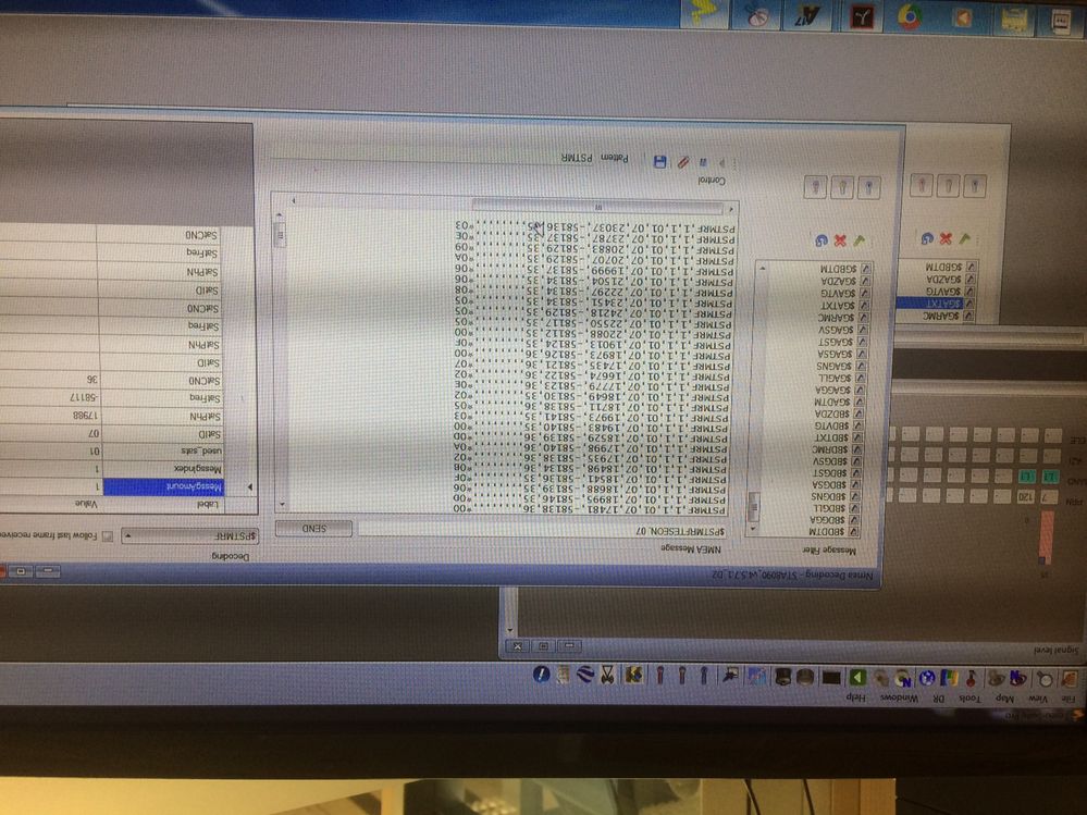

Another question. I set the CN0 of the GPS simulator 40dB/Hz. By using PSTMRFTESTON on satellite 7 sometimes I receive 36dB-Hz and sometimes nothing without doing anything.
0690X000006CBdiQAG.jpgDo you have any idea why this happens?
Also when I connect antenna nothing is received, even not a satellite.

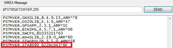

The "STA8089_4_5_10_BOOT26" is installed in the flash-memory and the TCXO frequency is 26MHz too (I use $PSTMGETPAR,1245 and the result is PSTMSETPAR,1245, 0X00000000*51 which means 26MHz TCXO).
But when I use $PSTMGETSWVER command, I get a weird answer.0690X000006CD0LQAW.jpg
I don't understand why the IC sends back STA8090 (as I said the IC I used is STA8089 GA).

On "STA8090_...622c..." isn't an issue, STA8090 and STA8089 are both Teseo_3, they sit on the same wafer ... they have only package difference.
