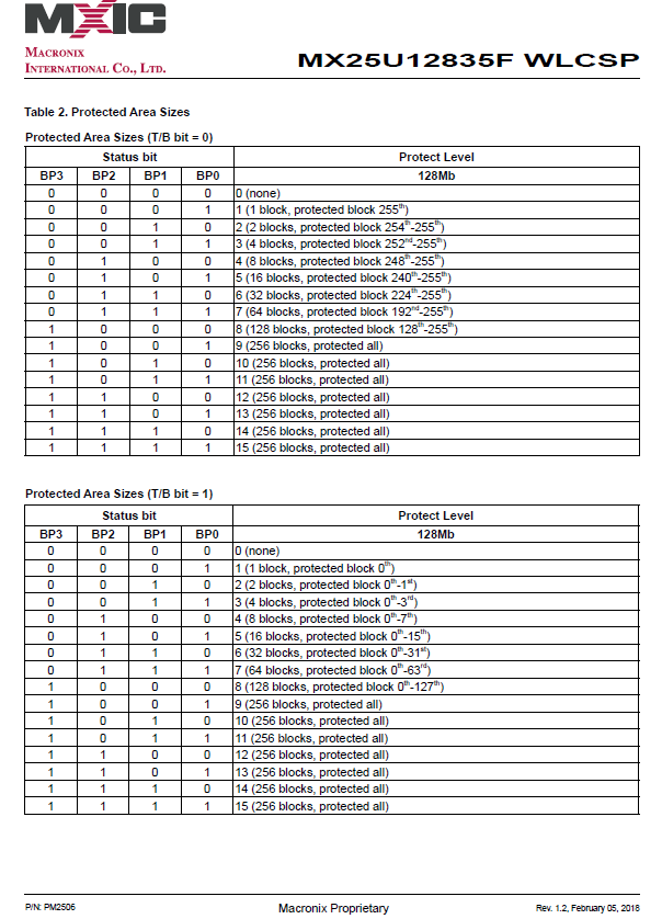

Associate III
The SPM table for the 128M flash we use looks different than the 32M device.
See below table from 128M flash device:

You advise gave us the clues we needed.
I actually changed only CDB-250 to 00000015 and now we have a fix. CDB-249 has the default value (enabled).
Is that a good setting?
Thank you.
Hi
This confirm the issue was related to the flash-protection.
> CDB-250 to 00000015
To be honest I was thinking to 0xA because the values for MX25U1635E/MX25U1635F
Why are you using 0x15?

In the document "SQI flash protection application note" it is shown further down the table that Macronix MX25L3233F and similar parts, also with the T/B field, use the 0x15 value. The MSB bit has to be '0' otherwise the lower byte value is ignored (a NOTE in the firmware guide: "when enabled the value configured in B0..B30 is not used").
