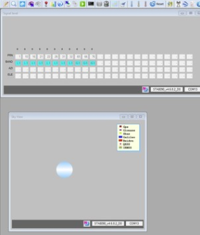

TESEO-SUITE is no longer displaying anything at all.
0693W00000Hpfv8QAB.pngI have tried the following to solve this problem.
A. I initialized the flash of Nucleo-F401RE and downloaded the sample software, but there was no change.
B. I reinstalled TESEO-SUITE, but there was no change.
C. When I check the serial communication with Tera Term, I can receive the data, but there is no longitude
and latitude information from the satellite.​
From the above results, it is the internal flash of Teseo -LIV3F that is suspicious.
Please let me know how to restore the factory default settings for Teseo -LIV3F implemented in X-Nucleo-GNSS1A1.

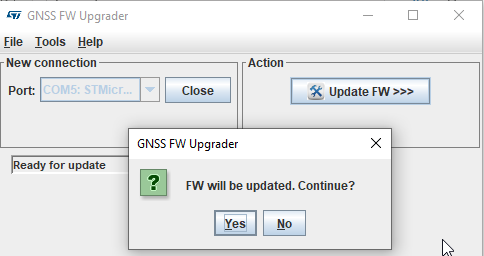

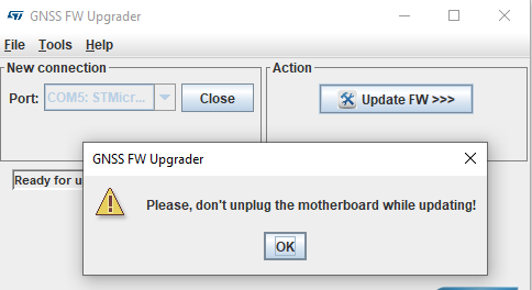

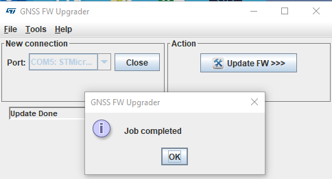

  • before clicking OK in the Please, don't unplug the motherboard while updating! pop-up, press the RESET button on the NUCLEO-F401RE and release it in as very short time (let's say about 1 second) after clicking OK. This will sync the Teseo-LIV3F device and will start the FW upgrading process.0693W00000Ns7KIQAZ.png
