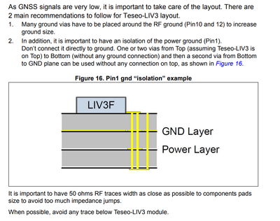

We have worked with the LIV3F during the last design. The topology followed the recommendations of "User Manual, UM2231, Teseo-LIV3 GNSS Modules, Hardware Manual.". Our main doubts start when we question the recommendation that this application note makes about an isolation power ground "inderectly" connected to the ground pad of the Teseo LIV3F. (8. Layout recommendation)
Why would something like this be required?
