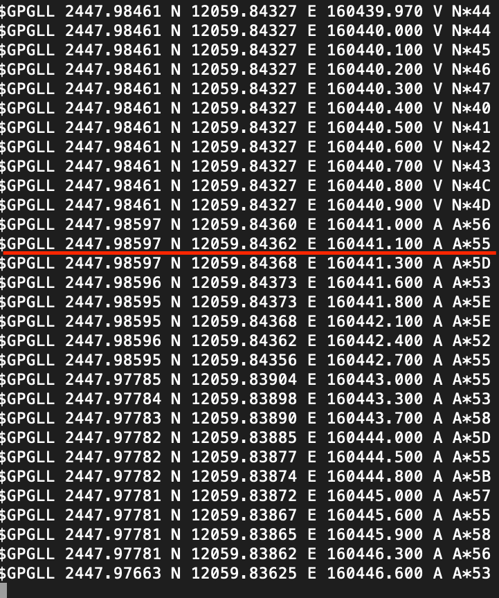

what I expected is update rate 10Hz, i.e., the timestamp is increasing 0.1 each time.
However, the result is
above the red line, one can see that it is updating at the rate of 10Hz
below the red line, it is updating at the rate approximately 3Hz
If I reset the program, it will maintain 10Hz for about 1 sec, then back to 3Hz.
If I power off the stm32 and power on, it will maintain 10Hz for a while, then back to 3Hz.

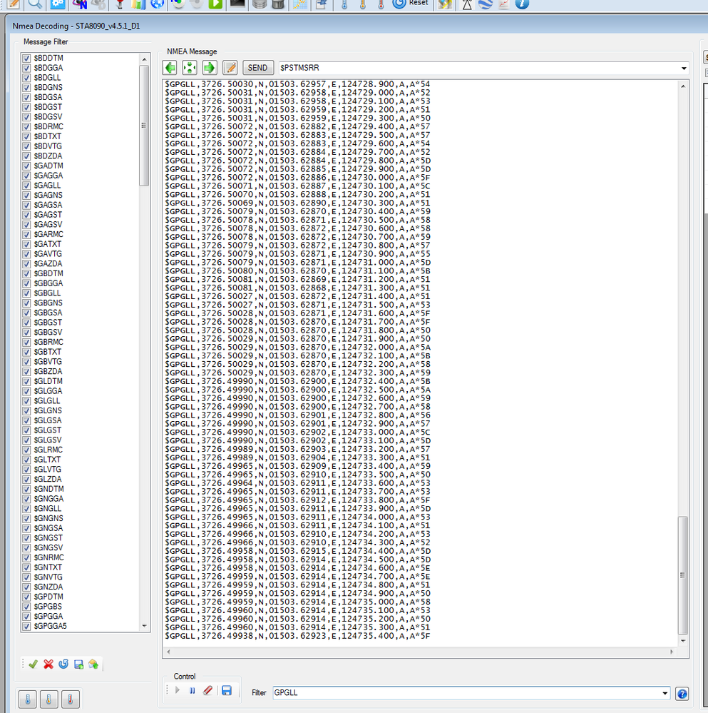

Hi
10Hz has to be working with and without valid ('A') field.
I have it working without problem as you can see in the image
I used the scripts provided in the past I also increased the UART-baudrate (115200)
No more than that. May be due to a baud rate too low the systems is skipping message
Let me know
