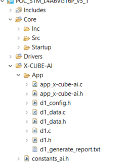

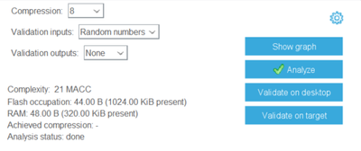

I'm currently working on a project that involves implementing Edge AI using the X-CUBE-AI software package within STM32CubeIDE. After adding the AI model, which requires 44 bytes of RAM and generating the necessary code, We encountered a problem: one of the peripherals, specifically I2C, starts hanging after a while when interfacing with a sensor to obtain readings.

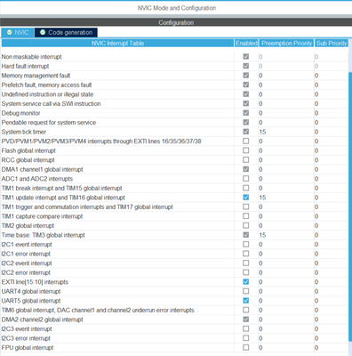

Peripherals in Use: Our project involves multiple active peripherals, including I2C1-3 and UART4-5.
