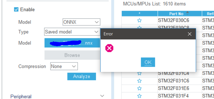

2023-05-29 7:41 AM - edited 2023-11-20 9:31 AM
Hi, i have the same problem.
I can generate an analysis base on comand windows in cmd console.
macc=6,532,325 weights=626,620 act=259,200 ram_io=3,300
Creating txt report file C:\WINDOWS\system32\stm32ai_output\network_analyze_report.txt
elapsed time (analyze): 113.465s
But it is not posible to obtain by cube mx
Any idea about how obtain at least the log failed test.
