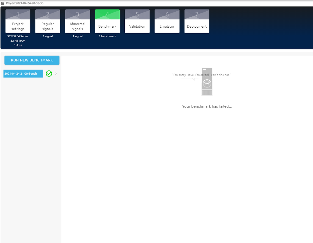

I used the simplest data for anomaly detection, but always failed to generate benchmarks. My setup screenshot with the data set is herelook forward to your reply

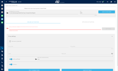

There are two paths used by Nanoedge:
Only the second one contains the special characters, and we can change its location directly in NanoEdge.
Go to setting and change the workspace location at the top:
For example, you can create a folder workspaceNanoEdgeAI directly in C: and select it.
You will need to click save and restart. Normally, you will not see your old projects (they are in the old workspace). You need to do a new project and see if it solved your issue.
Please let me know if it solved the issue or not.
