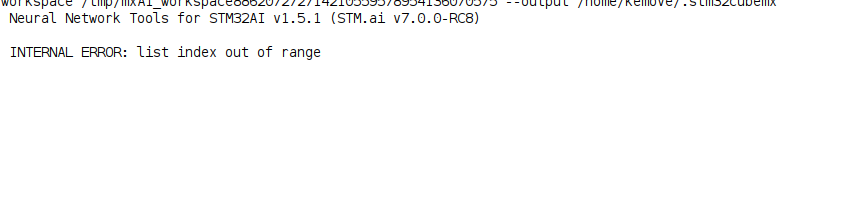

What the mean of "list index out of range"and 'params set for InstanceNormalization layer'?This is my first time to use cubemx,so I'm confused.Could anyone help me?Thanks!
MYChen
Associate II
When I use cubemx.ai to analyze a onnx model ,I get a error tells list index out of range,what should I do? When I analyze another onnx model ,it occur another error 'params set for InstanceNormalization layer'Could anyone help me?Thanks:confounded_face:

The model I use is a model which is transformed form pytorch to onnx.The model has no problem in pytorch and onnx.
MYChen
Associate II
error1:params set for InstanceNormalization layer0693W00000Dmwb3QAB.pngerror2:list index out of range0693W00000DmvrKQAR.png
MYChen
Associate II
The error about wish can be fixed by 'sudo apt-get install tk'.However I don't know why it will occur error 'list out of range'

I successfully transformed them form pytorch into onnx.The first problem about 'list index' arises when I use cubemx. AI to convert the Encoder model,and the problem adout 'params set for InstanceNormalization layer' arises when I use cubemx. AI to convert the Decoder model.
