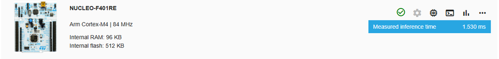

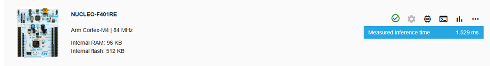

In terms of inference time, it is the same:
Not quantized:
Quantized (with above script):
Not quantized:
