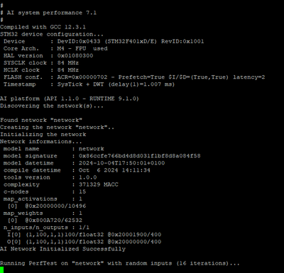

2024-10-06 6:44 AM
Thanks so much for providing the ST Edge AI Developer Cloud .
I used it to generate the STM32MX ioc, then generate code. It solved the Middleware missing problem, but when I run the code, it stopped at running the network.
Specifically, it stopped at
batch = ai_mnetwork_run(net_exec_ctx[idx].handle, ai_input, ai_output);
from aiSystemPerformance.c
2024-10-07 12:14 AM
Thanks for your answer, I will try on my side and give you a response as soon as I can.
For your information here is the inference time for NUCLEO-F401RE we have reproduced on ST Edge AI Dev Cloud.
Best regards,
