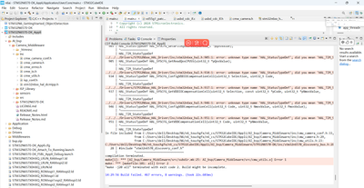

I have been using STM32N6 to conduct model training and deployment for the model zoo. Now, I want to transfer the generated code to my TouchGFX project for embedded use in the CubeIDE environment. However, when I am transferring several files, before the transfer, the original files did not have this error, but after the transfer, there is this error and it is particularly common, mostly for the official-generated code. As follows:

14:29:56 Build Failed. 467 errors, 8 warnings. (took 22s.603ms)
And there are over four hundred such error reports scattered across multiple folders.

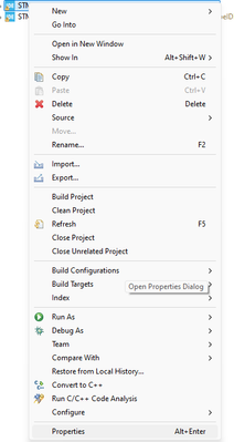

Go to Project Properties in STM32CubeIDE:

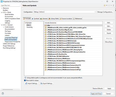

Right-click your project → Properties → C/C++ General → Paths and Symbols → Includes
Add the following (if not present):
Any custom middleware paths like:
Ensure stm32n6570_discovery_conf.h Exists:
Search your original project for the file stm32n6570_discovery_conf.h and copy it to the appropriate location, for example: <YourProject>/AI_bsp/Camera_Middleware/STM32N6570-DK/inc/

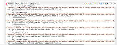

My problem has not been solved yet.Several files in the compilation project report the error "unknown type name 'HAL_StatusTypeDef'". When pressing F3, the definition can be seen. Redefining it in other .h files results in a duplicate definition error. I don't know what the reason is?Could you please show me? I'm really confused right now.

Did you include <your_project>/Drivers/STM32N6xx_HAL_Driver/Inc on "Paths and Symbols" under the "Includes" window?
