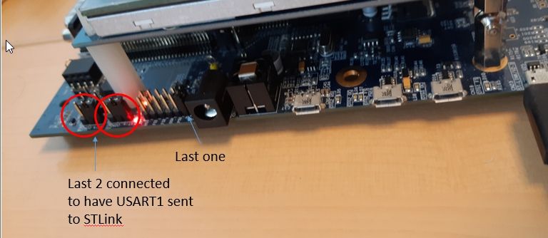

on this board there are some jumpers to put in the right place to have the USART1 sent to the ST-Link
and the USART1 is connected on PB14 and PB15
You should be able to use the automatic validation on the target specifying explicitly USART1 and PB14/PB15 for the ports
Otherwise you can always add the validation AI component to your project, enable USART1 in asynchronous mode, then in AI configure the Platform Settings to USART1, generate the code, flash it on the board then go back to MX to launch the validation on the target without auto generation

2019-11-20 3:29 AM
