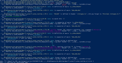

I use WSL to use make -j8, first issue I have is a failed build with the error "arm-none-eabi-gcc: error: unrecognized command-line option '-fcyclomatic-complexity'", Okay so I edit the make file to remove the '-fcyclomatic-complexity' comand line parameters. Then it begins to build but get stuck on the ll_aton_runtime.c file... Error callback pasted below. I'm guessing this is due to removing the '-fcyclomatic-complexity' from the makefile.
Now I am out of ideas. I feel like I am so close but I don't know if my code is being flashed to the board incorrectly or if there is an error in my postprocessing/application code. Any help would be greatly appreciated. I dont know why my STMCudeIDE wont run code. It would be really nice if I was able to run the code using development mode while in CubeIDE, but as I said that doesn't work for me unfortunately...
