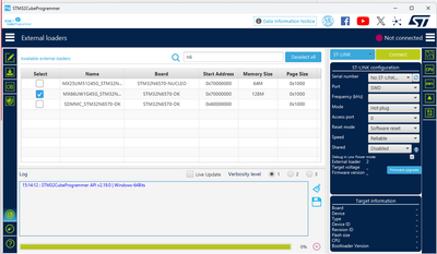

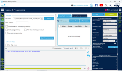

To deploy the getting started, you need to :
If you want to change the model, you need to follow x-cube-n6-ai-multi-pose-estimation/Doc/Download-and-deploy-model.md at main · STMicroelectronics/x-cube-n6-ai-multi-pose-estimation · GitHub
In short, generate the C file of your model with the ST Edge AI Core generate command, sign the file as the N6 is a secure MCU, edit the app_config.h with the right posprocessing (or create your own if you use a non-model zoo/supported mode). Then flash the new weight and application.
You can also edit the application to suits your needs the same way, save it, sign the binary, program it.
The FSBL will most likely never change.
Each time you modify the appli you need to sign and flash the new binary
Each time you change model, you need to generate, sign and flash the weights
