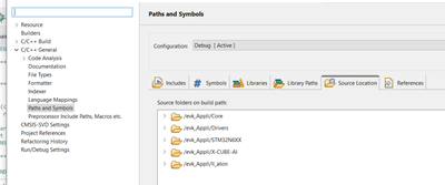

2025-02-19 9:54 AM
ok, so if I "Link Folder..." in Paths and Symbols to the Middleware folders that are not being built, it works. However if I regenerate code with the IOC, it removes these manual settings:
Is this a bug, or is there a way to force the IOC generation to include these middleware files in the source locations tab?
