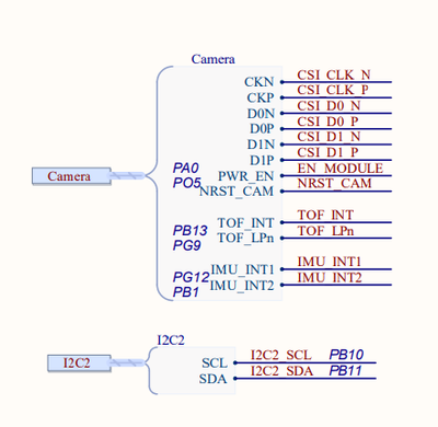

2025-10-09 10:41 PM
Hi @VABRI
I am working on connecting RPi 2 IMX219 to STM32N6 Nucleo board and I am new to Camera topic.
Do I need to configure CSI or DCMI or DCMIPP peripheral ? I got confused as schematic of Nucleo board has CSI labels.
